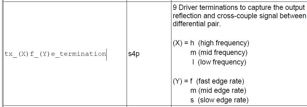

Please let me ask the tx_(X)f_(Y)e_termination.s4p file that relate to IBIS AMI model.
There are the parameter that are X and Y, and my understanding about frequency range is as below. Is my understanding correct?
  • h (high frequency) : Data rate (DR) > 3.4 Gbps
  • m (mid frequency) : 2 Gbps > DR < 3.4 Gbps
  • l (low frequency) : DR < 2 Gbps
Then please let me know how to select edge rate that is parameter (Y)?
