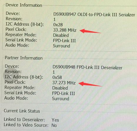

       I have DS90UB947-Q1EVM and DS90UB948-Q1EVM,and use coax line to connect with them, I could use the I2C and GPIO[3:0] function to DS90UB948 as deserializer, but now,I have some trouble to stop me from debug audio and video function.Please help me.
       1. I can't set the EVMs into BIST mode. For DS90UB948-Q1EVM, I set BISTEN=high,BISTC=high, then the PASS pin led can light up, but the LOCK pin still low. Why? Could you tell me how to check it?

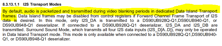

       2. For BIST mode, it can pass the I2S signal (audio)?
       3. Can I pass the I2S signal without video to DS90UB948-Q1EVM ? how to set the register ?

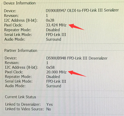

       4. When I use the ALP tool, I find the pixel clock of DS90UB947 and DS90UB948 are changing always, sometimes 21MHz,sometimes 33MHz, it's normal ?
