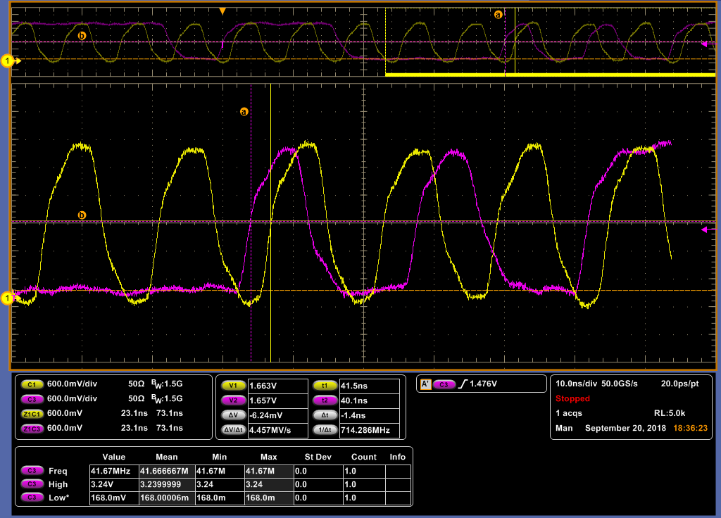

Customer designed DP83867IR as Ethernet controller and want to get the 100M/1000M Ethernet compliance test method from it.

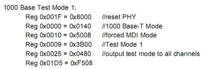

In datasheet, there are some command to force the DP83867IR into the compliance mode.
But customer try it, only one channel can transmit signal and the peak voltage can’t match the IEEE specification.
Please help to double check the command run under Uboot mode? Or OS mode? How to drive all channels?
