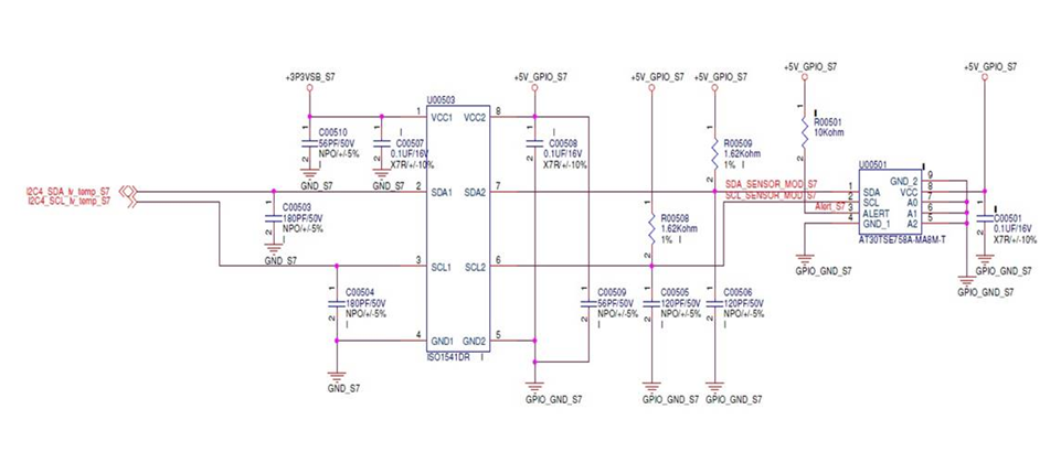

My customer is using ISO1541 on their board design.
But the falling time of I2C cannot meet the spec.
Do you have any suggestion or idea to solve this problem?

    Could you please confirm whether the above measurements mentioned are for Side1 of ISO1541 or for Side2?
    I see that the fall time, tf, is coming out to be ~13ns and is outside the range of ~20 to 300ns. Do you know how did customer get the ~20 to 300ns range? Shouldn't it be better if tf is lower than the range specified?
    The fall time can be increased by increasing the values of either pull-up resistor or the bus capacitance. Please make sure the max bus capacitance of 40pF and 400pF for Side1 and Side2 are not violated. Thanks.
    Koteshwar Rao
  • Hi Jim,
    Please do let us know if the lower tf is still a concern to customer or if customer could increase it using external pull-up resistor? Thanks.
