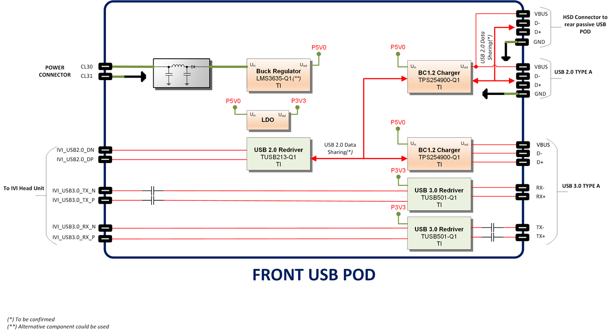

Hi TI team
I have to design an active USB POD that will be connected to an In-Vehicle-Infotainment head unit. You will find attached my first hardware block diagram. The interface of the USB POD is according to our customer specifications (Power connector, IVI interface, USB 2.0 type A, USB 3.0 type A and HSD interface).
I need your support regarding the correct use of the TI components. Mainly is the USB 2.0 data sharing possible using one TUSB213-Q1 and two TPS254900-Q1? or I have some other component? In addition, is it possible to use one TPS254900-Q1 for 2 ports (USB 2.0 type A and HSD interface)?
Please feel free to ask any additional information.
Thank you in advance.
