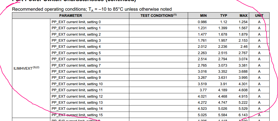

I do not know how can I set up a current value( OCP point ) for external path in TPS65982. As we all know, TPS65982 check internal path OCP and external path OCP current value . I only find how to set up internal path current value for 982 device, and could not find the file or documents for reference, how can I set OCP current value for external path?
Below is pic for internal current configuration.
