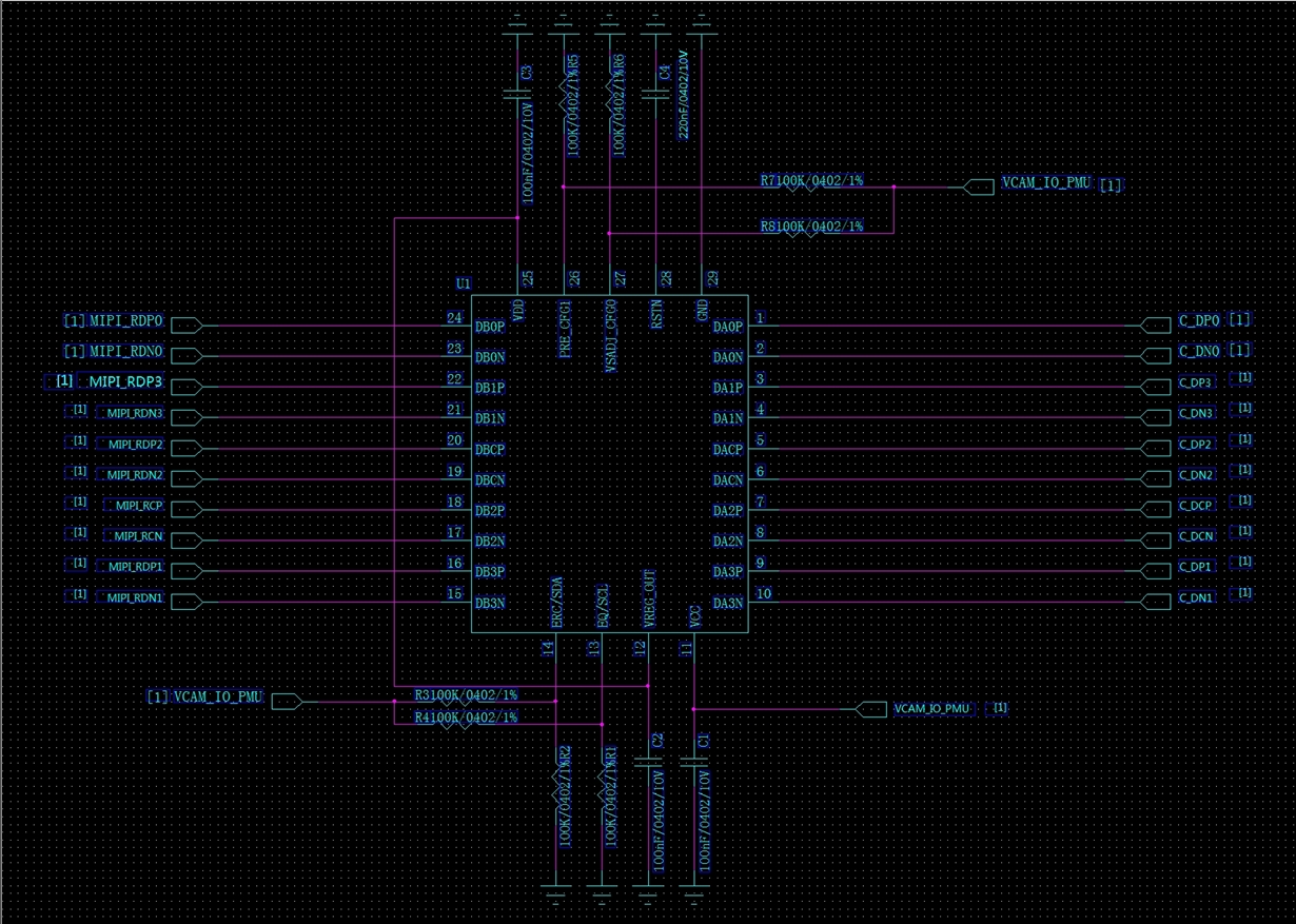

Part Number: SN75DPHY440SS
Hi
Could you help me confirm the circuit schematic?
Is it correct?
Thank you

Jerry
I will not use 100k for your pullup/pulldown resistor, recommend 4.7K for these resistor.
Everything else looks good.
