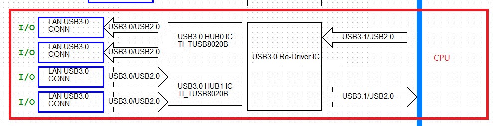

1. Our architecture is as follows. Will the TUSB8020 have doubts about its use?
2. The traces length of the SPEC line is described below. The recommended is 8 inch. Does this include the TUSB8020 body?
  • Hi AJ,
    No, that would be 8 inches of trace on either side of the hub. Please be aware that the hub has full USB phys on both upstream and downstream ports so typically a redriver should not be placed close to the hub since the hub works as its own redriver / retimer.

    1. If the Hub includes the Retime/Redriver function. How do I adjust the EQ?
    2. Can I remove the Redriver on the architecture diagram? Is it only TUSB2080B?
    CPU to TUSB8020B Less than 8 inch and Connector to TUSB8020B Less than 8 inch. Less than 16 inch in total. Is it?
  • Hi AJ,
    1. The hub has default USB 3.0 settings that cannot be modified. The TX strength of USB 2.0 can be adjusted by changing the value of the resistor on the USB_R1 pin.
    2. Yes, you can remove the redriver. Please take care the match differential pair trace lengths and match impedance.
    JMMN

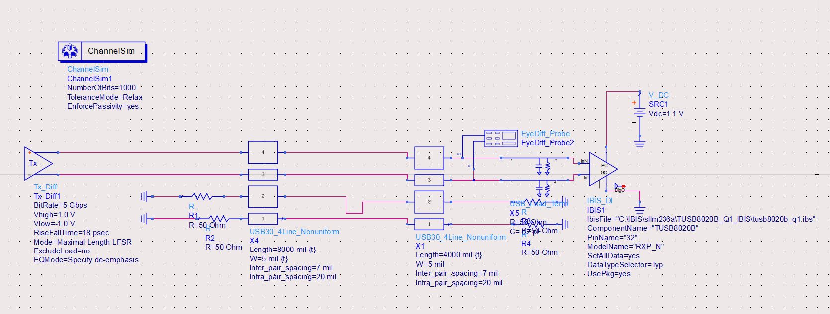

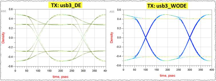

    Thanks for your reply. We have a simulation question and would like to ask you.

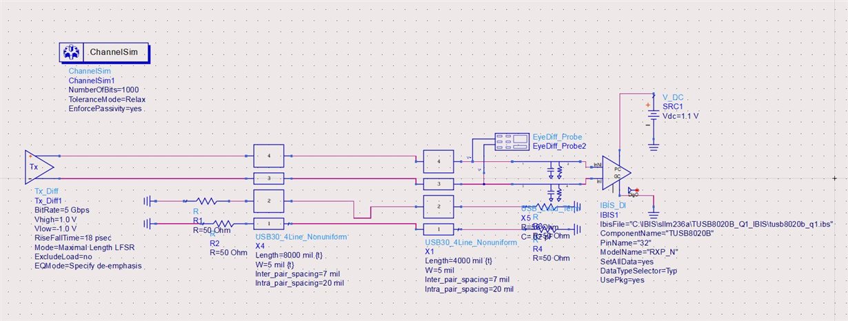

    Hub (TUSB8020B) IBIS model characteristic has qualm, simulation result were shown below

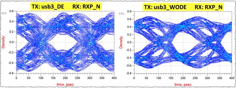

    Use Hub IBIS TX => Hub IBIS RX (Fig.1), eye diagram was disorder (Fig.2)
    Use Hub IBIS TX => 100ohm Termination (Fig.3), eye diagram was clear (Fig.4)
    So it seem RX model has qualm, please help to check model characteristic
    If the IBIS model couldn’t simulate for USB3.0 (5Gbps), are there other format models? (Ex. IBIS AMI)
    Fig.1 Simulation Deck for Hub IBIS TX => Hub IBIS RX

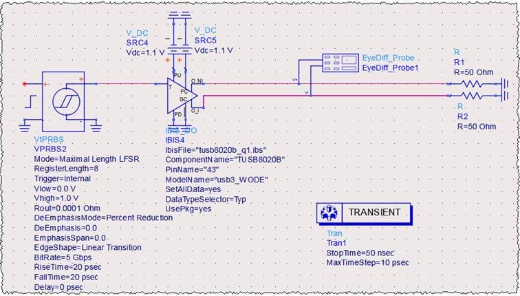

    Fig.3 Simulation Deck for Hub IBIS TX => 100ohm Termination
    Fig.4 Eye Diagram for Hub IBIS TX => 100ohm Termination(TX model: usb3_WODE)
  • Hi AJ,
    For USB 3.0 signalling there should be caps between the TX and RX which may impact the model. I'll check with the team.
    JMMN

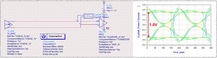

    Thanks for kindly help. More information update on below for you reference.
    Fig.1 result was simulated with ADS USB3.0 default TX model, TUSB8020B IBIS model’s characteristic was bed.
    Please help us to check IBIS characteristics was all right.
    IBIS model is a buffer model that it couldn’t build up with EQ, so it always use IBIS AMI to exhibit EQ characteristics.
    If the IBIS model can exhibit IC characteristics, please provide simulation deck. Thanks~
    Fig.1 ADS USB3.0 default TX AMI model ó Hub IBIS RX
  • Hi AJ,
    Add the differential termination to fix the eye.

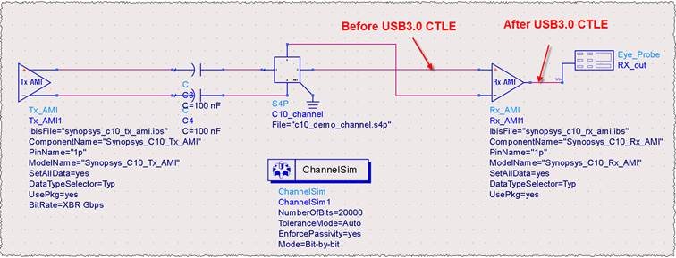

  • Dear JMMN
    USB3.0 considers the EQ characteristics to be observed after passing the component (Figure 1)
    But with IBIS, the simulation can only be observed in front of the component (Figure 2), and the simulation results will be different from the actual one.
    Can you please provide a simulation template (SPICE format or ADS deck)? Thanks for kindly help~
    Figure 1
    Figure 2
  • Hi AJ,
    We do not have a simulation template available.
    JMMN

    New simulation result were update shown below
    Fig.1 result was simulated from ADS USB3.0 default TX model to hub IBIS RX(TI_TUSB8020BPHPR) , the eye diagram in +-0.5V
    Fig.2 add 90ohm between P/N, the eye diagram in +-0.3V
    Adding 90ohm between P/N was unreasonable that it seems already have termination effect in IBIS model
    Fig.1 ADS USB3.0 default TX AMI model to Hub IBIS RX
    Fig.2 ADS USB3.0 default TX AMI model to Hub IBIS RX with 90ohm between P/N

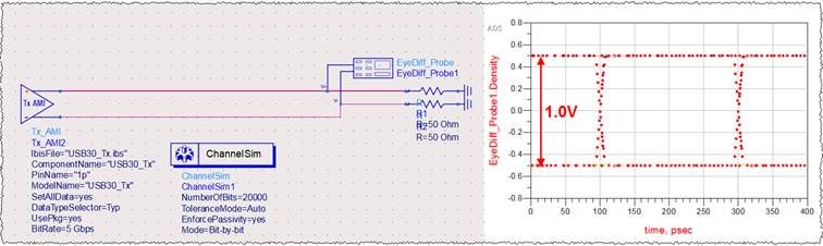

    We need to know the TUSB8020B IBIS model are correct or not? Or need to be modify some thing?
    Please also kindly provide the TUSB8020B simulation eye diagram result to us. Like our figures.
    Fig.3 ADS USB3.0 default TX AMI model to termination differential-100ohm. Remove TUSB8020B IBIS model and use an ideal termination to exhibit receiver characteristics. the eye diagram are perfect.
  • TUSB8020B IBIS mode is correct, please see waveform with ADS Full Link Behavioral TX model.
