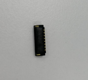

My customer is using DP83822 with non-standard connector rather than RJ-45, they are worried about the signal integrity issue. Could you please give us some suggestions or guidance on the following questions? Thank you!
1. What's the standard test process for Ethernet PHY? Is there any official document about the test regulation?
2. For the non-standard connectors, where and which pins should be tested? Do we need any specific equipment?
3. Can the differential probes be used to test the output signals and input signals? If so, how to make sure if the signal is good or not?

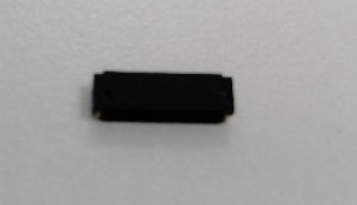

The female and the male connectors used by the customer are shown in the picture below:

  • Hi Hao,
    I think your questions are answered with the DP83822 compliance testing app note: www.ti.com/.../snla266
    Compliance testing is performed to ensure your Ethernet port is compliant with the spec and should be performed for each design, especially with non-standard connectors.
    If your non-standard connector passes the compliance tests, then the design would be OK.
