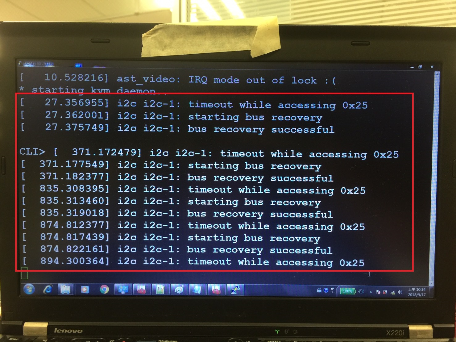

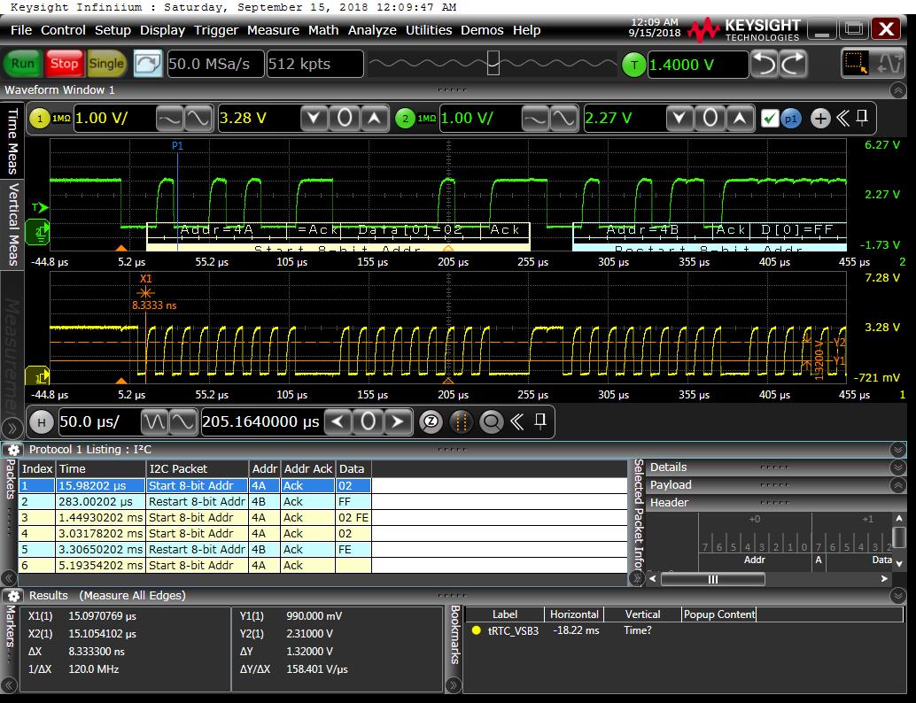

We have a project use TCA9555 and run I2C frequency at 100kHz, we use oscilloscope to measure the SCL rise time that is 844ns and meets I2C 100kHz criterion.
However, BMC chipset always feedback I2C device detection error of TCA9555 until we fine-tune timing requirement to meet 400kHz criterion (rise time < 300 ns)
We think we are under the IC spec(<1000ns) but BMC chipset always feedback I2C device detection error .
Is possible to explain it why have this phenomenon?
By the way, NXP PCA9555 no issue on the same condition.
