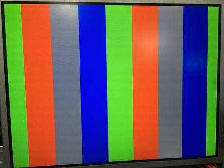

We test g104x1 and get the CSR list from DSI tuner. The panel  does not work. Is there anything we need to take care?

    Actually we can output the test pattern, but the color is lighter.
    Do you have any recommendations about this issue?

  • Hi Sirs,
    Thanks for your reply
    We can get the color bar as below. Is it correct?

    The PLL_EN bit and SOFT_RESET bit are not set as they need to be set per the recommended sequence defined in the datasheet

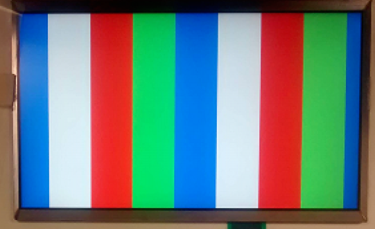

    Update our question as below
    You can see our test pattern , It’s different color with TI’s test pattern.
    We would like to know have any problem about our test pattern color?
    Our pattern
    TI pattern
  • Hi Shu-Cheng,
    It looks like that gray bar is not quite correct. Your settings look okay but can you try adjusting the HPW value? Additionally, I have not yet received confirmation that the initialization sequence in the datasheet is being followed. Please confirm that you're following the sequence.
