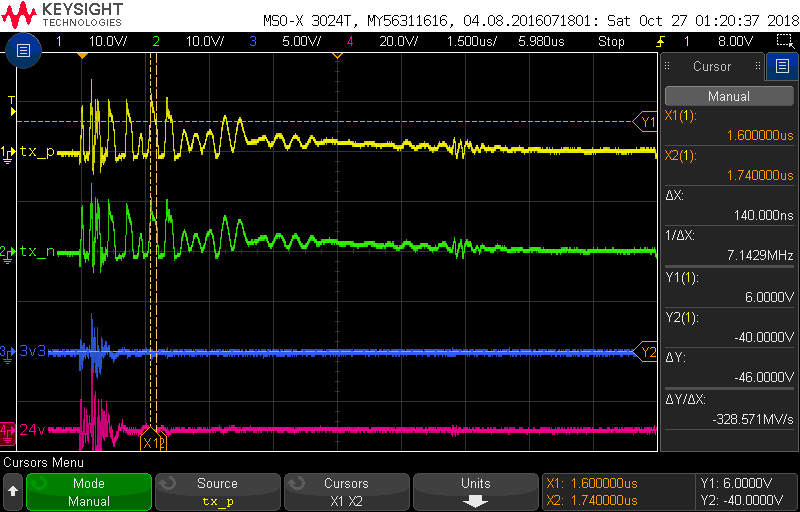

    I am currently taking measurements with a scope.  I am seeing some transients on the RS-422 driver lines during system power up, prior to even when the device has been enabled with VCC.  The transients last for about 5us and can go up to 10V, average pulse width of about 150 ns.  Systems are power cycled at least daily.  If the AM26LV31E gets transients he on the driver's diff pair outputs like this, prior to being powered up, can that be ultimately causing some of our failures?  Please see the attached traces TX_P, and TX_N.   This is what is on these interfaces about 180 us prior to the driver even getting VCC.  Other loads in the system are coming on at this time and have large inrush currents.  I see on the device datasheet an absolute max of 6V.  Do you have any information about what would happen to an unpowered driver with transients as shown?

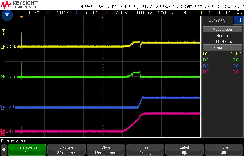

    Thanks. Yes the repeated exposure was what I was concerned about as well. The exposure to these transients would be prior to the device getting VCC, by about 180 us. I'm trying to determine the exact source of these disturbances, but I suspect that it is related to VFDs turning on and starting two 3 phase motors in the system. The transients occur right at switching on the main disconnect for the system, which starts the VFDs and motors. The cabinet also has a switching power supply, 24V, which is used by the PCB where this 422 driver is, the 24V goes through a hot swap controller and filtering, then to a switching power supply to generated the device's 3.3V VCC. I think some of the transients are from radiated noise during the turn on, as I've had some success at least partially attenuating the transients with improved shielding of the 422 pair. I'm currently looking into adding TVS and small series resistors on the driver's output as I've seen in some other posts on here. I'm considering the CDSOD323-T03 or CDSOD323-T05. I'd like to clamp transients above 6V if possible, but allow for normal operation at 3.3V.
    Andrew
  • Max,
    Here's a larger time scale view of the turn on and transient event.

    I tested a couple of parts in lab by shortening TX_P and TX_N pins to 10V supply (individually or simultaneously) for 10s of seconds. But so far I haven't seen a device failure. Can you confirm your ground connection during your tests? Thanks,
    Hao
  • Hao,
    Is that measurement with no VCC applied to the part?
    My scope probe ground leads are as short as I can get them at the moment, returning to the driver ground plane. Perhaps I could sketch up a diagram of the setup if needed. This device runs off a 3.3V switching P/S with a 24V input that comes from a hotswap controller. Ground is common on everything in the PCB with the 24V return. The 24V return does come through a blind mate interface, which is engaged, otherwise it is all hard wired back to an industrial control panel which runs off 480 3 Phase and has a 24V switching P/S inside of it. The control panel also has the VFDs I mentioned that are starting up motors which I suspect there to be transients from.
    The parts you tested seem robust to handle 10V, I assumed that was so much more than the 6V abs max that it would cause damage. Do you think all parts would behave the same?
