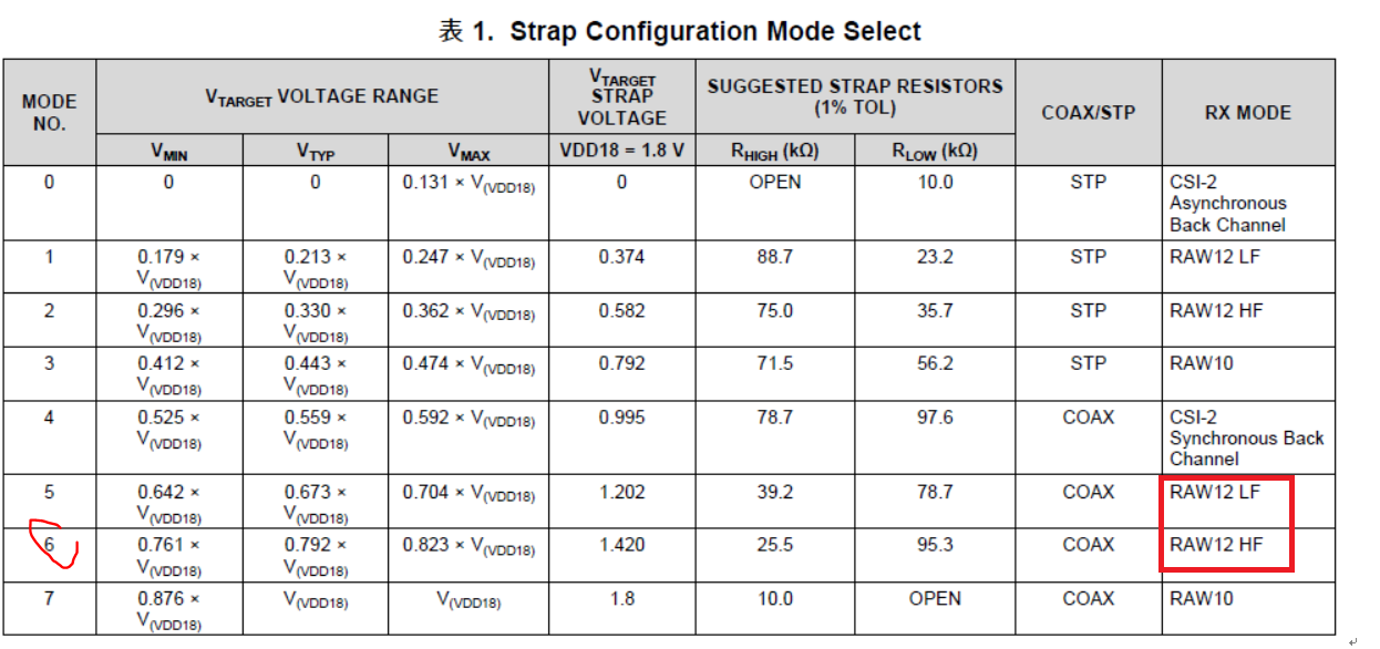

Part Number: DS90UB954-Q1
Hi
In mode select. What is the difference between RAW12 LF and RAW12 HF?
thank you
Jerry
