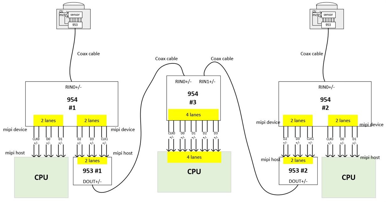

Dears:
Is the design OK?
4Lane mipi is separated to 2 part, and connected with CPU and 953 to make the video is transmitted to the next 954 through 953.
Dears:
Is the design OK?
Dear Steven,
To complete the design above, if I add an additional input source to the middle 954, as shown in the attached figure, so that 954 #3 would receive two inputs from two seperate 953, and the input of each 953 is a 2-lane mipi csi2 port. I want the 954 #3 to aggregate the two 2-lane mipi source from 953#1 and 953#2 to a 4-lane mipi csi2 output, is this design OK?
