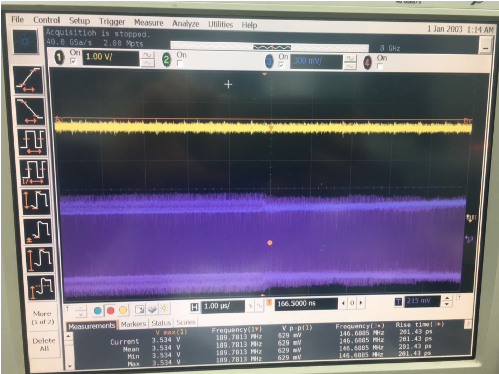

Our customer is seeing a problem on our product which uses a TFP410 encoder in which the DVI Tx diff out clock frequency is jumping from 121.5MHz (1400x1050@60Hz) to ~153MHz for about 9us interval. The IDCLK input is reported to be stable during this event as well as the DC power supply. Based on the frequency jump failure results where it changes from 121MHz to 153Mhz in one clock period (see CH1 scope shot below), were surmising that the TFP410 has an internal DLL and what our customer is seeing is a skip on a DLL tap selection.

  • Thx for the confirmation that it is a PLL and not a DLL. Based on new data from our customer the clock actually shifts from 121MHz to 153MHz and then drifts back to 121MHz over time.
    As for the PVdd (course view screenshot from customers scope) it doesn't look like there are any glitches (at trigger) on the rail but I need to convert wfm data file and zoom in (will post later). As for circuit design, the filtering on the power supply has the 10uF prior to the bead (vs after as recommended) but we've used this design on over a thousand units (10+ years) and have never seen an issue. Our customer has used the board in two different applications (bench setup with bench power supply) and second setup installed in their embedded system and both setups have seen the frequency jump/skip issue.

    The customer has seen the problem on 4 out 5 units on the last batch of 15 units delivered (other 11 remained un-tested). One of the failing units is being returned to us for analysis. The customer originally encountered the failure during cold temperature testing but it was reproduced at room temperature on two different setups. The frequency jump usually occurs within 20 minutes of power-up and more often than not within 5 minutes. We have done some minimal temperature testing (freeze spray / heat gun) at our facility with no duplication of the failure.
    We tried two tests on our side to re-produce the failure by forcing the failure by insertion of input timing errors and noise injection on the power supply. The first test was to phase shift the data in clock relative to the data/sync inputs until visual effects were noted. The thought here was to test if there was any interaction between Hsync not meeting setup and hold timing requirements versus PLL operation. We did not see any shifts on the output clock and the design appeared to have plenty of timing margin.
    The second test used a signal generator to modulate the input power to the board at between 1 to 5% duty cycle (off) ranging from 100kHz to 5MHz modulation. This injected about +/-100 to 200mV of noise on the +3.3V rail. The test did at times generate perturbations on the DVI output clock but generally resulted in a falling clock rate in which it appeared the PLL went offline momentarily. It did not duplicate what our customer was seeing.
