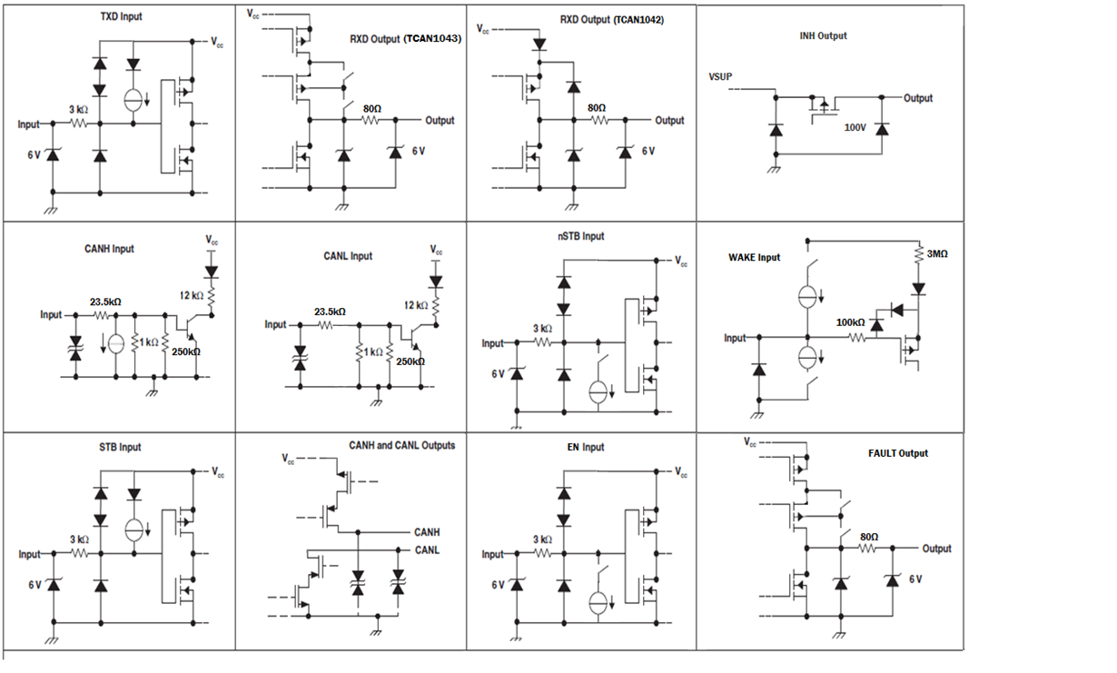

To TI technical group
This is Ichizono of KTL (distributor).
The Customer want to document of the TCAN1043's Equivalent input output schematic.
It is necessary for parts registration.

Dear Hackett-san
Thank you for your suport. I'll respond this document to customer.
