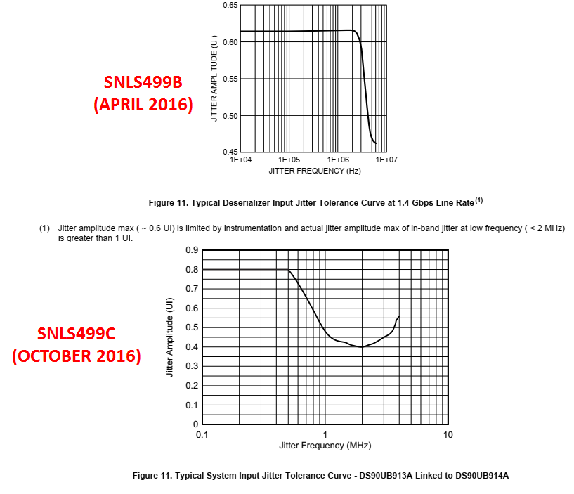

[ DS90UB914A-Q1 ] Jitter Tolerance Graph
The Jitter Tolerance graph has been updated from Revision. B to Revision. C datasheet.
Can you please elaborate on the background of this difference?

Thanks, Pal,
That is what I can see on the datasheet.
What I expected to hear from you is the reason and/or background why the graph was renewed.
My own guess would be that you had something like test limitation came from your equipment, then, reperformed measurement with new equipment.
I don't know it's true, but this is what I can guess from footnote on the old datasheet.
"(1) Jitter amplitude max ( ~ 0.6 UI) is limited by instrumentation and actual jitter amplitude max of in-band jitter at low frequency ( < 2 MHz)
is greater than 1 UI "
