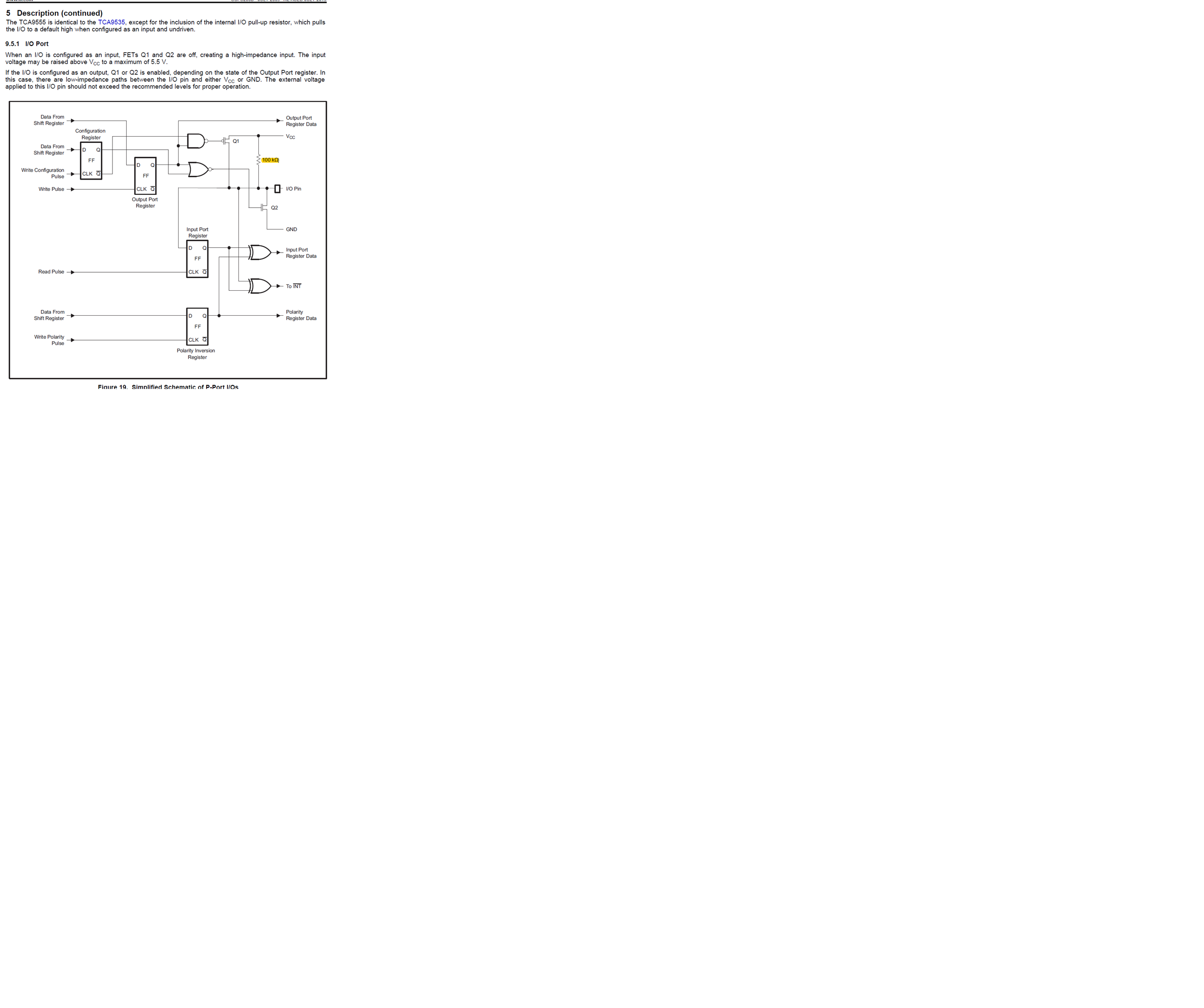

Hi, My customer have a question about TCA9555RTWR I/O pin.
Is it internal weak pull high 100K to Vcc when sets to input and undriven?? Could you help to check? Thanks
