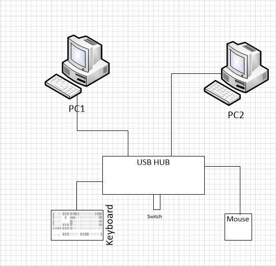

    I am designing in using FSUSB30 ic to switching between two upstream port, and when i am doing that switching there is the delay of around 10s to recognise the second PC.
    and so I am thinking to reset the register while shifting the upstream port,
    any suggestion over that?

  • Does it will resolve the issue of the delay in switching upstream port,
    and how much delay will require at USB_VBUS input?
    How to reset the GRSTz manually any circuit reference for that?
    Please find the arrangement of my application.
    looking forward to your reply in near future.
    Thanks.
  • Hello Mukesh,
    If USB_VBUS is low or GRSTz is held low, the hub will disconnect and not try to connect on the upstream port. The timing will be determined by the switch on the upstream port, this is not something that can be defined by the hub.
