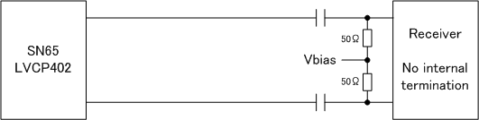

  • Hi Lee-san,
    Thanks for the information.
    When AC coupling the output, I am understanding that 100 ohm differential termination is only required at the receiver input only.
    4). If AC coupled, where would you recommend to place the AC coupling cap ? Is it close to the receiver side ?
    5). Is the following general connection correct for this VML ?
    Kawai
  • Hi Kawai-san,
    Yes since there is no termination internally an external termination should be placed as close as possible to the Rx device.  Some receivers develop there own internal bias.  If this Rx does not, then you are correct to establish a Vbias common mode voltage to optimal Rx performance.
    4. I would recommend to place the AC coupling closer to the Rx side of the interface, but the actual location is not critical.  I would avoid placing the AC coupling within 10-25mm of the LVCP402 output to minimize any reflections.
    5. Yes this connection is correct.
    Lee
