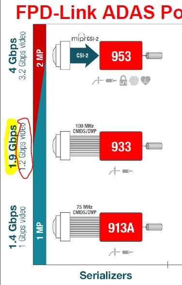

Hi Ti team,
What are the differences between the following two parameters? 1.9Gbps and 1.2Gbps Video
How to calculate the rate fo line? thanks!

video rate is: PCLK x video data width
line rate is: video rate + control data and the unused data bit width (such as : RAW 10 modes, 2 bits are not used for 8bits video width).
