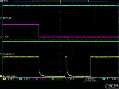

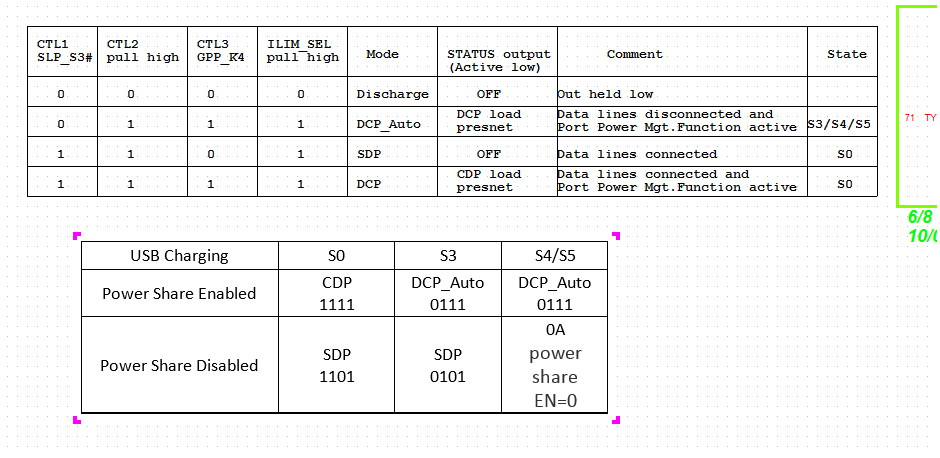

Customer captured OUT waveform as below and questioned why OUT discharged twice when charge mode change from CDP to DCP_Auto? Can you please comment?
Randy Chen
Randy Chen
Hi Chuck,
Customer is checking the Data lines waveform and should responded soon. Thank you for your comment.
