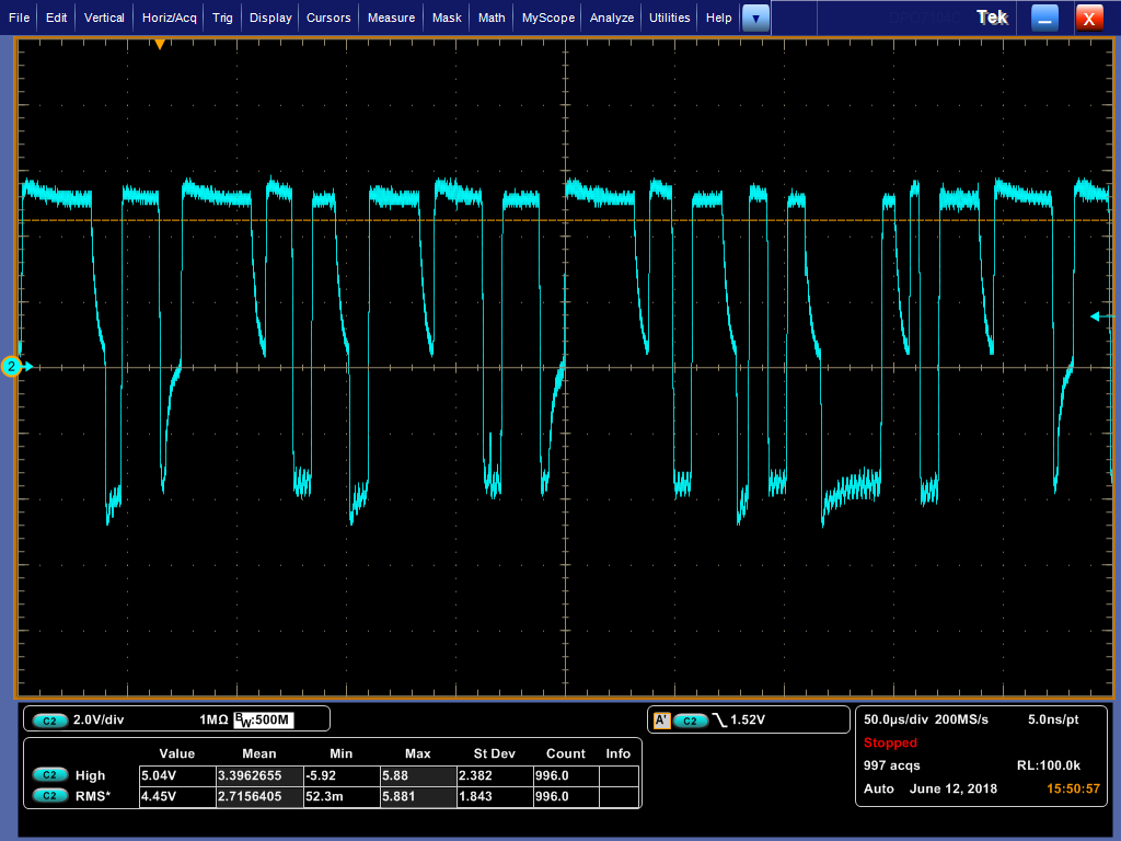

We use MAX3243EC in our project, the issue is, it works normally when bps set to 9600, but it returns a code corrupt if set to any higher bps.
Also we use the same circuit as the recommended loopback test circuit in the data sheet. Could you give us some suggestion? Thanks
The fail waveform as below.

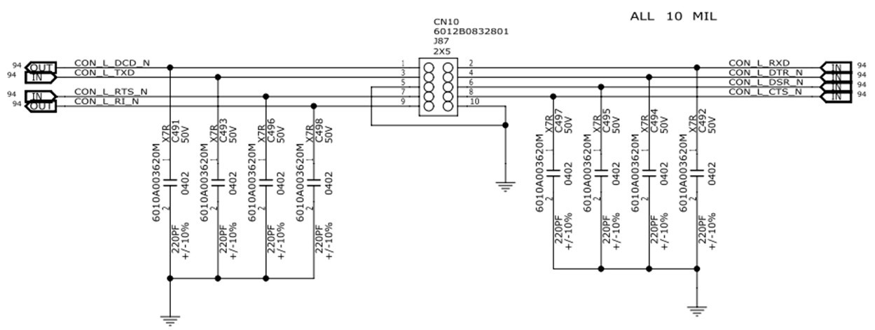

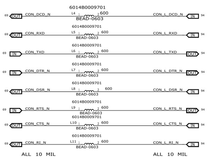

  • Hi Hao,
    Here are the picture of 3243 to RS232 connector.
    The P3V3_STBY has no current limitation for 3243 chip.
    The COM loopback test will have the signal sent from TXD to RXD, so the loading of Dout is the Din of 3243.
  • Daniel,
    To be honest, the schematic looks good to me. Can you double check your loop back connection? If the connector is DB9, usually pin 2 and pin 3 are shorted. You can refer to this article. When it goes to IC level, the Dout shorted with one of the Rin. Please let me know if it makes sense.

    I just wanted to check back in - have you had any luck in debugging this? I think Hao's comments about checking the connections makes sense, since if you have two different output lines shorted together you may see waveforms like this. (The combined output will be high if both outputs are driven high, will be low if both outputs are driven low, but could be at an intermediate state if the two shorted outputs are driving opposite one another.) It may help to debug if you probe the DIN lines along with the DOUTs to see if the "drooping" of the signals corresponds to a particular data pattern. It could also be useful to double-check the V+ and V- signals to see if they show the same behavior.

    To debug the issue, you can disconnect the loading from all Tout pins and check the voltage of V+ and V- pins. Without any loading, V+ and V- voltage should stay around 5.4V and -5.4V. You can also compare the V+ and V- voltage between two capacitor configurations. If they all look good, you might be able to figure out the cause by adding the loading back one by one.
