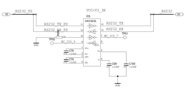

it seems we are facing some radiation problems with that parts we use in EP grade. We inspect our PCBA with X-Ray since on the board we have three BGA components.
The transceiver is not directly exposed but it is located at around 1.5 cm from a BGA part. We calculated that it should receive a dose around 0.5Gray whic is very small but we see changes in the Voh, see the table:

Coud you please tell me if you have a reference value of acceptable radiation that part can withstand? Which are most sensitive elements within that component?

    Can you indicate the schematic of the output drivers? What loading?

    Here an extract of the schematic attached. The measure is done on a not used line so no load charge and at input we have a pull-down of 10K ohm, measure done on TP51.

    I found a paper indicating that this device was tested to 8Krad without significant change in performance. So, I would not expect 50rad to even be detected. Either there is higher dose than you are estimating, or there is something else going on in the circuit.
    Can you operate without exposing to radiation source? Does behavior change?
    Has this been seen on multiple units?
    Are your capacitors polarized, and if so mounted in correct orientation? (Schematic does not show they are polarized).
    Do you see same degradation on pin 9, or is only on the RS232 side?
