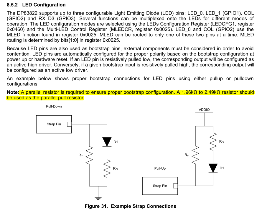

Quick question regarding DP83822I design for EtherCAT.

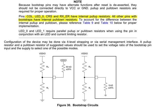

LED_0, LED_1/GPIO_1 are strapping pin.

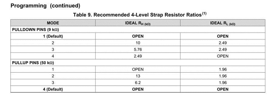

Data sheet mentioned , choosing RH/RL resistor value based on MODE selected.
In below statement, datasheet said LED pin needs parallel resistor (DP83822 EVM is 2.49Kohm)
Customer is wondering, is it meant besides RH/RL resistor, they need to add additional resistor like below?

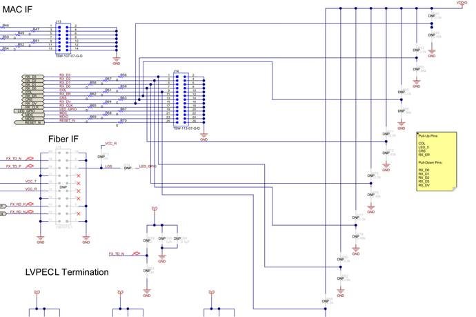

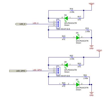

EVM:
LED_0, LED_1/GPIO_1 didn't populate RH, RL resistors.
