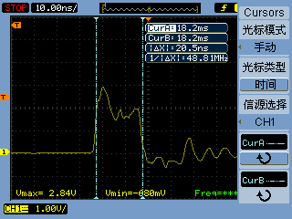

  • Hi Sean,
    Thanks for your reply. I don't know the load of SOA since there's nothing at its website. But I'm contacting the manufacturer to request the information. Meanwhile, I tried to connect 5 Ohm as load, used 300mA output channel, and set pulse width as 20ns. The pulse is around 1.5V which is correct for 300mA. However, the overshot approximate 2.8V, and some ripples at pulse certainly decrease the laser's performance. Could you give me any suggestion on dealing with this unexpected pulse shape?

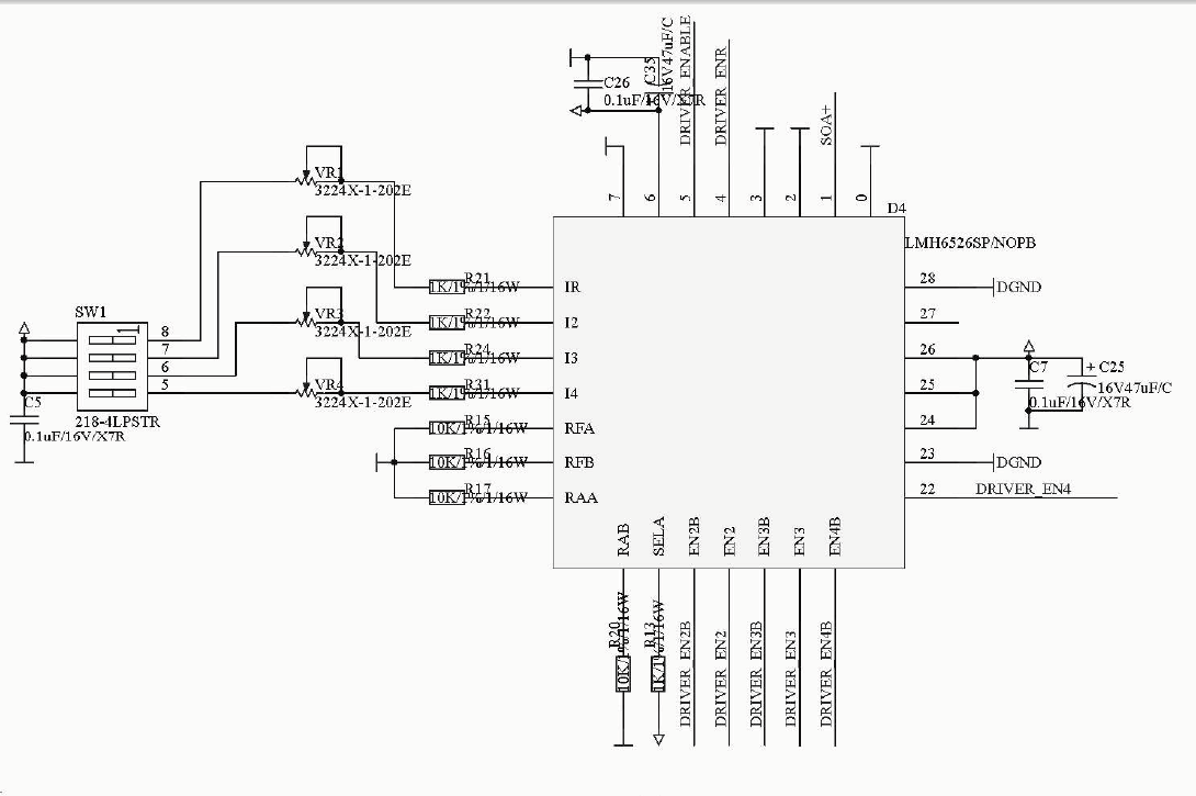

  • Something is definitely wrong. Can you please show us your circuit. What are your Rf and Ra values? What are you using to drive your input current signal?
  • Please check the circuit below. I only used channel 2 to send a differential pulse signal in and turned off internal oscillator by connecting to ground.
  • Hi ZQ,
    How are you injecting the input current? All I can see is a switch to ground connected to I2 through a variable resistor and a 1k resistor? Typically this function is done with a current output DAC.
