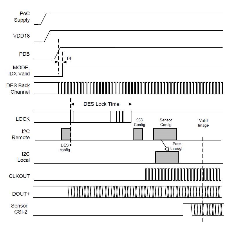

Customer found sometimes it will occur CSI Error (0x4e bit3 is set) after power cycle initial UB953/UB954.
It will let host side cannot receive frame.
We checked UB953 spec. about power sequence, it need wait for "DEC LOCK TIME" between initial UB954 and initial UB953.
We checked with d/s for lock time(tDDLT), the max. will be 300ms
Customer try implement lock time(tDDLT)=300mS found the issue will gone.
But their end-customer has spec. for initial serdes duration need <=64ms.
Pls advise how we can do for satisfied no issue and duration<=64ms?
Thanks, Ian.
  • Ian,
    The datasheet specs are what we can guarantee, so if the full AEQ range is used it would be a max of 300ms. If faster lock time is desired, it is possible to limit the AEQ range to achieve 30ms max for +/-3 AEQ settings, but the customer needs to test and qualify their system to ensure limiting the AEQ still gives sufficient performance to operate error-free based on their channel and system characteristics. Refer to the 954 datasheet on AEQ settings and registers.
