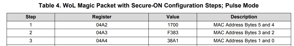

  • Hi Hamamoto-san,
    You also need to configure registers 0x136 to 0x138 with the local MAC address.
    Without the MAC address, the PHY assumes the MAC address is 00-00-00.
    Please see the DP83822 app note on configuring the MAC address:
    www.ti.com/.../snla261.pdf

  • Please use the example of the DP83822 WoL app note to help you understand how to configure Magic Packet.
    However, the actual register address is different from DP83822 to DP83867.

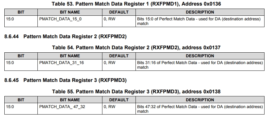

  • Hi Ross-san,
    I am sorry for the delay in my response.
    They had confirmed the register of 0x0136~0x0138.
    0x0136 : 0x2202
    0x0137 : 0x4433
    0x0138 : 0x6655
    (MAC: 02:22:33:44:55:66)
    However it does not change anything. What should we confirm next?

  • Hi Ross-san,
    I referred the App Note of DP83822. The MAC address to register set at the address 04A2 to 04A4.
    On the other hand,for DP83867 the address is 0136 to 0138. Is that correct?
    On the customer board, they registered as the following.
       0x0136 : 0x2202
       0x0137 : 0x4433
       0x0138 : 0x6655
     However it does not still work. What should we do next ?
    (In addition, the register of 0x0135 was "0x001c" )
    If you would like to know the other register setting , I can send that setting information on the private message.
