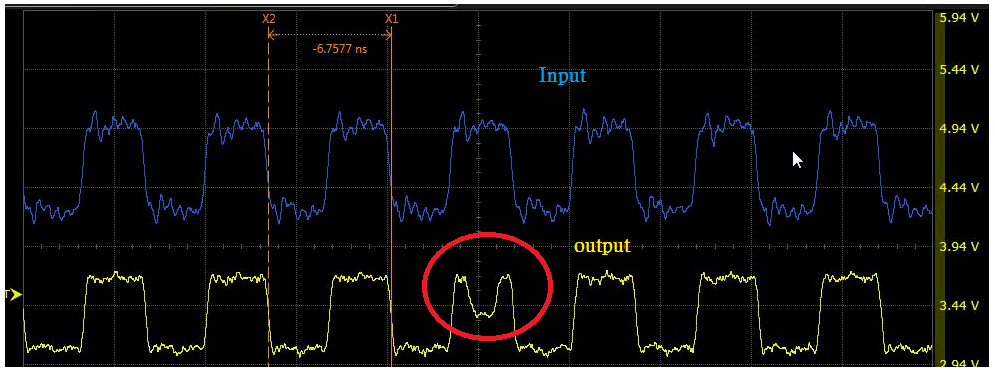

We currently found a issue of SN65LVCP408 in our video matrix application.
We are feeding 7 sets of differential clock signal as the input signal of the SN65LVCP408.
The typical application is to pair the input and output by switching the different profiles. When switching the profile, we will change the status of PIN "SWT"
We found the output signal at port 7(only port 7) twists whenever we switch the profile from profile A and profile B.
Input port 7 is directed to output port 7 in both profile A and profile B.
In our application, if the output clock signal twists at port 7, output video will flash and come back. That's not something we want. We want a seamless switch.
We are not sure anything we miss in our circuit....
If possible, can anyone provide the reference design of this SN65LVCP408? There are not much info. on the website.
Attachments are our circuit and measure signal

    Do you have the register programming?  I would like to go through the port configurations.
    Do you have a scope wavefrom of the SWT transition and the odd clock waveform?
    What are the other 6 input clock frequencies?

  • No, it only happens when switching.
  • Hi, Lee,
    I'll get you the register and the SWT transition later. The other clock frequencies are 148MHz.
  • Hi, Lee,
    The register is here. We set the profile A and profile B identically on purpose.

    The clock starts twisting after  "SWT" rises above VIH  6 ns.
    We also notice the clock only twists on SWT rising edge, but not falling edge.
  • The issue also happened when we did't feeding any signal on the other six ports.

    There are two things we want to ask:
    1. Why does clock signal twist at port 7 when SWT rise? Is this a potential issue from IC?
    2. We found another way to switch profile without the need of SWT.
    We simply modified the port 0~port6's register in profile A (, port 7 does't get modified ) through I2C when we want to switch. We didn't really switch from profile A to B. It still stayed in profile A, but it looked like we did because the content was changed.
    By doing this, we didn't rise SWT and twist our clock signal. But we are not sure this is a valid way to do so...or is there any side effect ?
  • I just wanted to know if you could read back all the registers and get the expected results.
    1. It may be part of the way the device operates.  I am working to put together hardware to test this function in the lab.
    2. This sounds like another method to accomplish the same type of function.
    Lee
