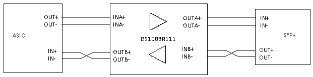

We use DS100BR111 to repeat a 10G SFI signal.
To facilitate PSB layout, I intend to swap the polarity on both sides of the device.
Is this connection acceptable?
Thanks in advance.

Yes the connection is okay. Swapping the P/N signals will not change the DS100BR111 operation. Make sure the SFP+ and ASIC connections are AC coupled.
