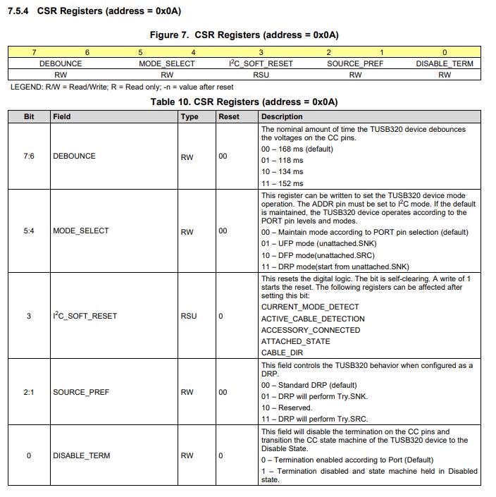

On the TUSB320 is there a way to set it to DRP but always default to SINK if connected to another DRP? If this is possible, can you walk me through the configuration settings that need to be adjusted?
