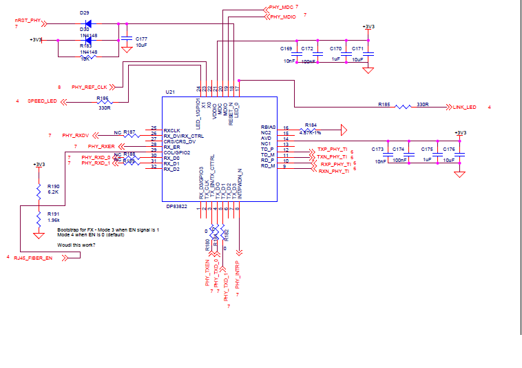

  • Thanks for the info. We don't expect this change is often. Just an option.  Attached a schematic and let me know any feedback. It looks to me that
    - we may need a mux on COL strap res value for mode 3 and mode 4
    - once the user changes to fx mode - enable mode 3 and do PHY reset so it can use strap value to change mode 3. Do the same when user changes to TX mode.
  • Hi Barani,
    Your schematic looks ok. I need to add that you should have a parallel pull-up resistor of 2.2k - 2.49k with your LED_1 and LED_0 current limiting resistors.
    I think your RJ45_FIBER_EN signal and scheme will work if you can drive a high on that pin. When you need FX mode 3, you should hi-z whatever may be driving the RJ45_FIBER_EN signal.
    Your sequence for changing modes is also correct.
    You would set the state of RJ45_FIBER_EN as you want(hi-z = FX, 0 = TX) then send a RESET pulse to the PHY.
