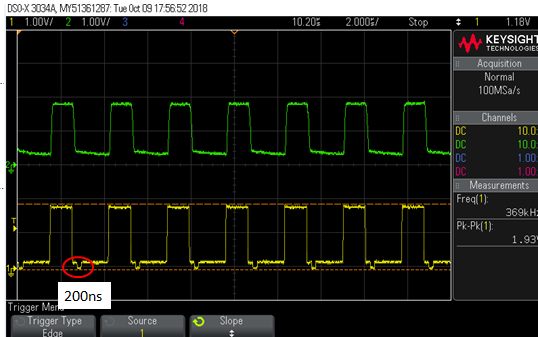

            I use TCA9803. Wehn I enable output , My imput have 200ns will be low to GND.
Is it normal ?
CH2 is output
CH1 is input

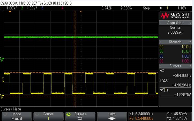

The file is Enable and disable waveform.

    Is yellow side A and green Side B or is it opposite?

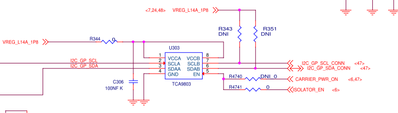

  • Hi Bobby
              The file is schematic. The waveform is on port A ( A side ). I have try to install R343 and R351. It have same issue.
  • Hey Kerr,
    I don't see any issues with your schematic.
    Taking a second look at your waveform pictures, it does look like the yellow waveform is rising a little fast. Is the master driving the yellow waveform open drain? To me it looks like you are using a push pull output.

  • Hey Kerr,
    I just checked with one of the design engineers who worked on this device. It looks like this behavior is normal and happens every time A side goes low. Usually though, the master/slave has a low enough VoL that this step isn't seen but if the master/slave has a weaker pull down strength then this step becomes visible.
    There is no danger of the device being damaged (or other devices on the bus) due to this behavior.
