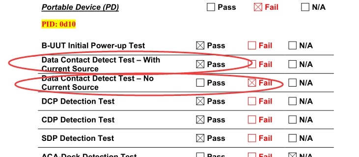

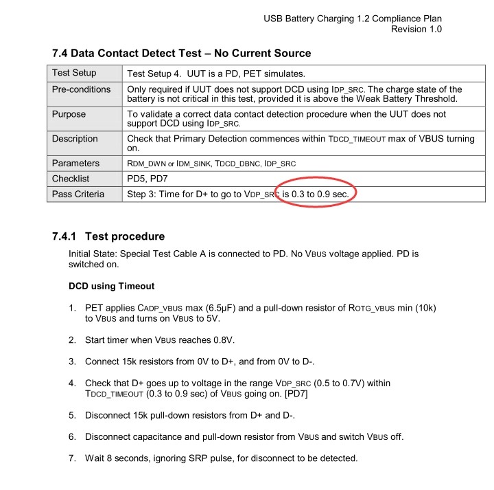

Dear TI Expert,
My customer failed to pass BC1.2 test about D+ timing, below is the schematics, test result, could you kindly help to give some advice? Thanks a lot.
1) below is the spec of BC1.2
2) Below is the schematic
3) below is the test result:
