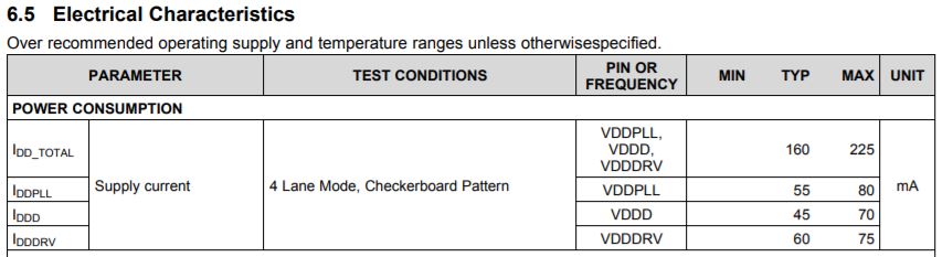

we've noted that the typical supply current characteristics is the same for the 935 as for the 953 serializer, despite lower speed.
Is that correct?

Hi Bartosz,
The DS90UB953 does have a higher speed, but for this spec it was tested with the same configuration and speed as shown in the DS90UB935 datasheet. That is why they are the same.
Mike
Hi Bartosz,
Sorry, I have looked through the characterization data and have not been able to find any data for 4.16Gbps.
Mike
