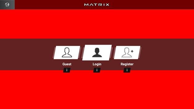

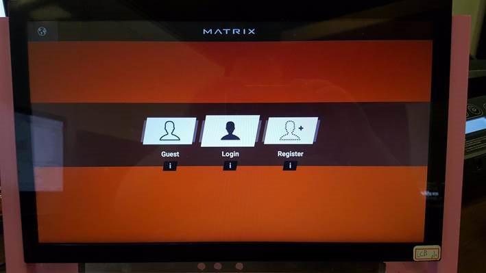

Our customer is using SN65DSI84 and encounter a problem.
The display color is not as expected.
This is the original picture:
But the display show as below:
Do you have any experience about it?
Can we set registers to modify it?
Or it should be tuned by video source?
Thank you very much

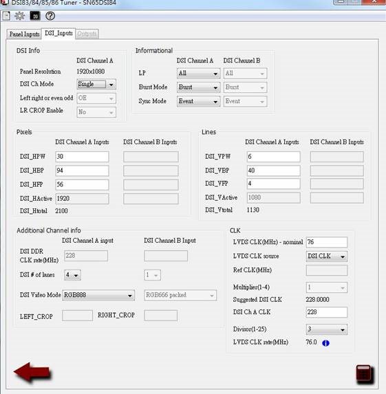

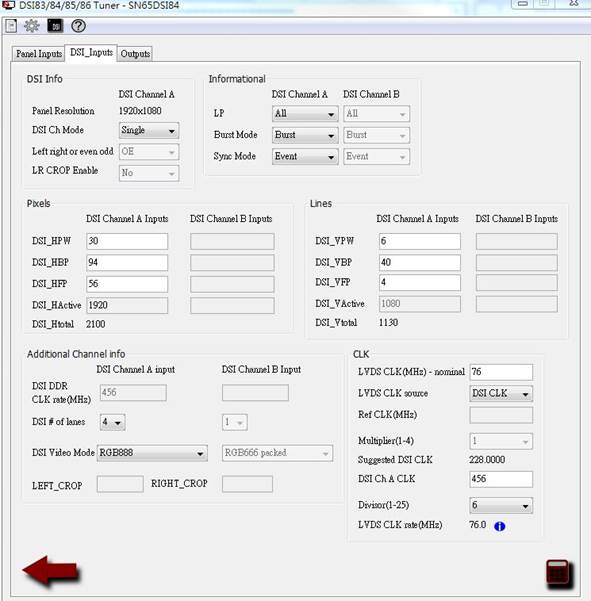

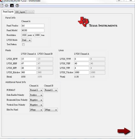

  • HI CK Ho,
    Can you send the display datasheet and the .dsi file from the DSI-Tuner that was used to configure the register settings?
    I.K.
  • Dear I.K.,
    Belows are the datasheet and the register settings:
    G156XW01 3.pdf
    G215HVN01 1.pdf
    //- 15.6 inch, For 1366 x 768
    /*Dmesg from kernel*/

    //- 21.5 inch,  For 1920 x 1080
    jht_8mq:/ # dmesg |grep DSI84-I2C
    [    2.762404] DSI84-I2C: read 0x00  - 0x35
    [    2.763336] DSI84-I2C: read 0x0d  - 0x00
    [    2.764266] DSI84-I2C: read 0x0a  - 0x05
    [    2.765203] DSI84-I2C: read 0x0b  - 0x10
    [    2.766137] DSI84-I2C: read 0x10  - 0x26
    [    2.767067] DSI84-I2C: read 0x18  - 0x6c
    [    2.767998] DSI84-I2C: read 0x1a  - 0x03
    [    2.768934] DSI84-I2C: read 0x20  - 0x80
    [    2.769864] DSI84-I2C: read 0x21  - 0x07
    [    2.770796] DSI84-I2C: read 0x22  - 0x00
    [    2.771729] DSI84-I2C: read 0x23  - 0x00
    [    2.772662] DSI84-I2C: read 0x24  - 0x00
    [    2.773590] DSI84-I2C: read 0x25  - 0x00
    [    2.774510] DSI84-I2C: read 0x26  - 0x00
    [    2.775431] DSI84-I2C: read 0x27  - 0x00
    [    2.776352] DSI84-I2C: read 0x28  - 0x1f
    [    2.777039] DSI84-I2C: read 0x29  - 0x04
    [    2.777961] DSI84-I2C: read 0x2a  - 0x00
    [    2.778882] DSI84-I2C: read 0x2b  - 0x00
    [    2.779805] DSI84-I2C: read 0x2c  - 0x0f
    [    2.780728] DSI84-I2C: read 0x2d  - 0x00
    [    2.781658] DSI84-I2C: read 0x2e  - 0x00
    [    2.782588] DSI84-I2C: read 0x2f  - 0x00
    [    2.783519] DSI84-I2C: read 0x30  - 0x06
    [    2.784449] DSI84-I2C: read 0x31  - 0x00
    [    2.785384] DSI84-I2C: read 0x32  - 0x00
    [    2.786316] DSI84-I2C: read 0x33  - 0x00
    [    2.787246] DSI84-I2C: read 0x34  - 0x2f
    [    2.788179] DSI84-I2C: read 0x35  - 0x00
    [    2.789105] DSI84-I2C: read 0x36  - 0x00
    [    2.790025] DSI84-I2C: read 0x37  - 0x00
    [    2.790947] DSI84-I2C: read 0x38  - 0x2f
    [    2.791868] DSI84-I2C: read 0x39  - 0x00
    [    2.792791] DSI84-I2C: read 0x3a  - 0x00
    [    2.793655] DSI84-I2C: read 0x3b  - 0x00
    //-21.5 inch, For 1920 x 1080
    /*Set the registers on driver*/
    /* Soft reset and disable PLL */
    i2c_smbus_write_byte_data(dsi84_i2c_client, DSI84_SOFT_RESET, 0x01);
    i2c_smbus_write_byte_data(dsi84_i2c_client, DSI84_PLL_EN, 0x00);
    /* four DSI lanes with single channel*/
    i2c_smbus_write_byte_data(dsi84_i2c_client, DSI84_DSI_CFG, 0x26);
    i2c_smbus_write_byte_data(dsi84_i2c_client, DSI84_DSI_EQ, 0x00);
    /* set DSI clock range */
    i2c_smbus_write_byte_data(dsi84_i2c_client, DSI84_CHA_DSI_CLK_RNG, 0x2D);
    i2c_smbus_write_byte_data(dsi84_i2c_client, DSI84_CHB_DSI_CLK_RNG, 0x00);
    /* set LVDS for single channel, 24 bit mode, HS/VS low, DE high */
    i2c_smbus_write_byte_data(dsi84_i2c_client, DSI84_LVDS_MODE, 0x6C);
    /* x resolution high/low for channel A */
    i2c_smbus_write_byte_data(dsi84_i2c_client, DSI84_CHA_LINE_LEN_LO, 0x80);
    i2c_smbus_write_byte_data(dsi84_i2c_client, DSI84_CHA_LINE_LEN_HI, 0x07);
    /* x resolution high/low for channel B */
    i2c_smbus_write_byte_data(dsi84_i2c_client, DSI84_CHB_LINE_LEN_LO, 0x00);
    i2c_smbus_write_byte_data(dsi84_i2c_client, DSI84_CHB_LINE_LEN_HI, 0x00);
    /* y resolution high/low for channel A */
    i2c_smbus_write_byte_data(dsi84_i2c_client, DSI84_CHA_VERT_LINES_LO, 0x00);
    i2c_smbus_write_byte_data(dsi84_i2c_client, DSI84_CHA_VERT_LINES_HI, 0x00);
    /* y resolution high/low for channel B */
    i2c_smbus_write_byte_data(dsi84_i2c_client, DSI84_CHB_VERT_LINES_LO, 0x00);
    i2c_smbus_write_byte_data(dsi84_i2c_client, DSI84_CHB_VERT_LINES_HI, 0x00);
    /* SYNC delay high/low for channel A */
    i2c_smbus_write_byte_data(dsi84_i2c_client, \
    		DSI84_CHA_SYNC_DELAY_LO, 0x1F);
    		DSI84_CHA_SYNC_DELAY_HI, 0x04);
    /* SYNC delay high/low for channel B */
    		DSI84_CHB_SYNC_DELAY_LO, 0x00);
    		DSI84_CHB_SYNC_DELAY_HI, 0x00);
    /* HSYNC width high/low for channel A */
    i2c_smbus_write_byte_data(dsi84_i2c_client, DSI84_CHA_HSYNC_WIDTH_LO, 0x0F);
    i2c_smbus_write_byte_data(dsi84_i2c_client, DSI84_CHA_HSYNC_WIDTH_HI, 0x00);
    /* HSYNC width high/low for channel B */
    i2c_smbus_write_byte_data(dsi84_i2c_client, DSI84_CHB_HSYNC_WIDTH_LO, 0x00);
    i2c_smbus_write_byte_data(dsi84_i2c_client, DSI84_CHB_HSYNC_WIDTH_HI, 0x00);
    /* VSYNC width high/low for channel A */
    i2c_smbus_write_byte_data(dsi84_i2c_client, DSI84_CHA_VSYNC_WIDTH_LO, 0x06);
    i2c_smbus_write_byte_data(dsi84_i2c_client, DSI84_CHA_VSYNC_WIDTH_HI, 0x00);
    /* VSYNC width high/low for channel B */
    i2c_smbus_write_byte_data(dsi84_i2c_client, DSI84_CHB_VSYNC_WIDTH_LO, 0x00);
    i2c_smbus_write_byte_data(dsi84_i2c_client, DSI84_CHB_VSYNC_WIDTH_HI, 0x00);
    /* Horizontal BackPorch for channel A */
    i2c_smbus_write_byte_data(dsi84_i2c_client, DSI84_CHA_HORZ_BACKPORCH, 0x2F);
    /* Horizontal BackPorch for channel B */
    i2c_smbus_write_byte_data(dsi84_i2c_client, DSI84_CHB_HORZ_BACKPORCH, 0x00);

  • Dear I.K.,
    Belows are DSI setting:
  • Hi CK,
    The DSI settings look okay except for the DSI CLK. I believe 228MHz is too slow for the 1920x1080 panel and will result in a line time mismatch. Please try with the below settings instead:
    The DSI CLK needs to be 456MHz, and the divisor needs to be 6.
    I.K.
  • Dear I.K.,
    We set the DSI CLK to 456MHz, and the divisor configure to 6, but it does not work, the panel shows black screen.
    The setting as below:
