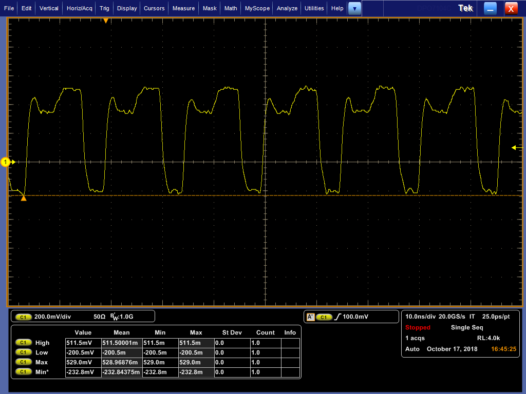

Hello Sir,
Would you advice how to modify DSI83 VOD due to some LCD need 400mV(min) ? Is there register setting sequence need to care ?
If possible,pls share your VOD waveform for our reference .
TKS !
Below is LVDS output and change 0x19 3:2 to "11" . Don't see VOD change.

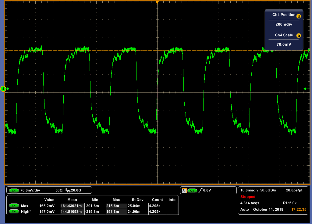

Below is change termination from default 200 ohm to 100 ohm.
0x19 3:2 still "11" and disconnect LCD panel .
