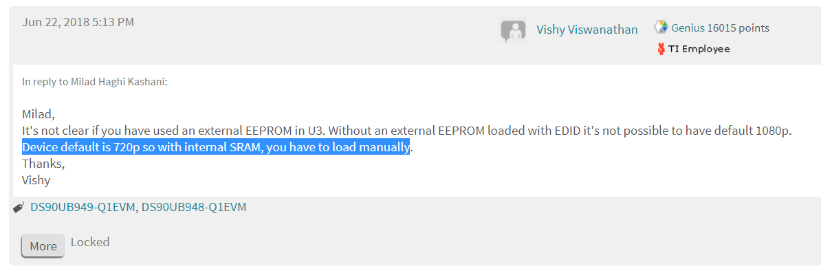

      Below link, it's said "Device default is 720p so with internal SRAM, you have to load manually".
      https://e2e.ti.com/support/interface/f/138/p/693834/2558965?tisearch=e2e-sitesearch&keymatch=run%201080p#2558965
      My question is how to load 1080p manually,please show me the reference setting. Thanks a lot.
    please refer to DS90UB949 Datasheet, Section "8.4.2.2 Dual Link Operation".
    Dual Link mode may be automatically configured when connected to a DS90UB948-Q1/DS90UB940-Q1, if the video meets minimum frequency requirements. Dual Link mode may also be forced using the DUAL_CTL1 register (0x5B)
