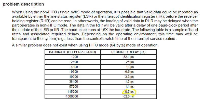

Could you please let me know about "required delay" on baudrate.
Compare with TL16C752B(SLLS405C), TL16C752B(SLLS405A) and TL16C752-EP(SGLS153B), required delay time on 115kbps is different.
I guess 0.5us is correct relay time on TL16C752B(SLLS405C), right?

  • Thank you for pointing this out.
    You are correct, the SLLS405C would be the correct values.
    The EP version suffers and issue with tranlation when the datasheet was created. In a very unfortunate translation problem, the micro symbol translates to an "m". This makes all the micro seconds milliseconds. Fortunately, the column head included the micro symbol.
    Also, as you inferred the correct value for 115200, the delay should be 0.8uS.
    I will get this in queue for update.

  • Pokkun,
    I expected that the 0.8uS is correct, as the commercial datatsheet was updated to reflect this.
    However, mathematically, the delay should be 0.5uS based on all the other timing relationships.   I will need to research this.
    Conservatively, 0.8uS can be used.
    For all the mS in the table, they should be uS.  The conversion changed the micro symbol to an m erroneously.
    I will reply back with if confirmation on 0.8 or 0.5 for the 115200 delay.

  • Pokkun,
    I was not able to find any information on why it was changed from 0.5uS to 0.8uS. I believe this to be a typo in the commercial datasheet.
    Based on the fact that the delay is 1/16th of the baud rate for all other rates, this supports that it is a typo.
    Architecturally, the internal clock runs at 16x the baud rate. This explains that the delay is up to one additional internal clock.
    Please use 0.5uS as appropriate delay for 115200 baud.
