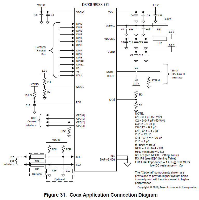

Hi Team,
The datasheet recommends C1=0.1uF and C2=0.047uF for coax application.
Could you tell me the background why C2 should be set approximately half capacitance value compared to C1?
Is C2=0.1uF problem?

Yaita,
for coax cable application, it is equal to single-end signal transmission, and it has one more cap. in the paired side (de-ser side), so the C1 value is double to make the diff. output pins have equivalent AC coupling cap.
