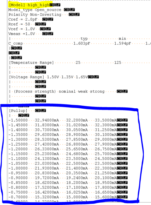

  • Kawai,
    [Driver Schedule] is used to describe a driver with pre-emphasis/de-emphasis behavior.  High_high, medium_high and etc describe timing differences between different voltage levels that constitute pre-emphasis behavior. You can find more detail regarding this driver schedule in IBIS specification document attached. the Pullup (for rising edges) and pulldown (for falling edges) information in the blue box is information that is actually called when simulating this driver.
    Does this answer your question?
