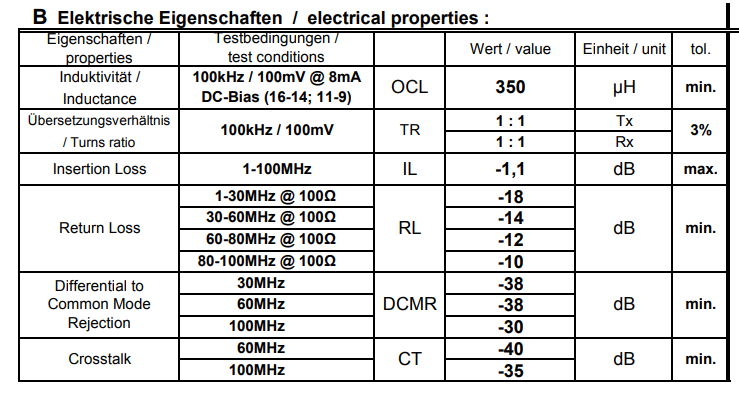

My customer is using the DP83848KSQ/NOPB and they are facing an issue where the connection link comes up and goes down repeatedly. I have included the snip of the schematic.

Do you have any recommendations or places to start in order to stop this behavior?
