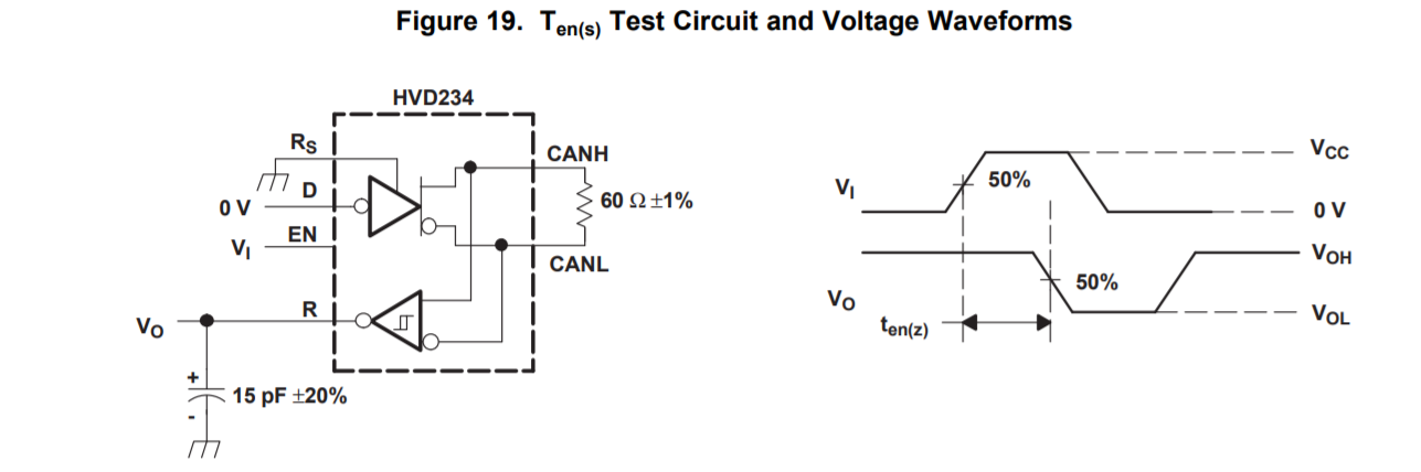

I'm having some issues/questions regarding the enable line on this part.
With Rs grounded, setting the enable line doesn't appear to shut off the driver.
Figure 19 on the datasheet:
With Enable at Vcc, it appears the output voltage (Voh and Vol) will drive to below 0.4V (Vol)
I have tried both at Vcc and at Gnd on the enable line, and it doesn't seem to change the output (multiple chips), any ideas? I like to disable to driver completely.
Rs is low, D is high (does this input matter?), driver output still have voltage on it.

    You should be seeing the device function normally whenever EN is high. That is, you should see toggling on the D pin transfer through to the different CANH/CANL outputs and reflect back via the R output. Is this what you are seeing, or is the R output always low? (Does the device ever function properly in your testing?)
    Just so I can clearly understand the issue, can you please let me know the voltages at the CANH/CANL/R pins for the different possible states of the EN and D input pins?

    So here are the states (Rs=0V both cases):
    Disabled:
    1) D=0.2V, R=3.3V, EN=0V, CANH = 3.3V, CANL = 3.3V
    1) D=3.3V, R=3.3V, EN=0V, CANH = 3.3V, CANL = 3.3V
    Enabled:
    2) D=0.2V, R=0.0V, EN=3.3V, CANH=3.3V, CANL=0.4V
    3) D=3.3V, R=3.3V, EN=3.3V, CANH=2.2V, CANL=2.2V
    Is this normal behavior? I'm trying to shut down the driver such that CANH & CANL both equal to 0V.
    Billy

    The voltages you report for the enabled case are normal.
    When the device is disabled, the CANH and CANL lines are made high impedance. If nothing else is connected to the circuit, in most cases I would expect the measured voltage at CANH/CANL to be near 0 V. If there are any sources of pull-up current, though, they may appear "stronger" than the disabled driver and result in a high voltage measurement.
    Does your circuit match the image you posted above (Figure 19), or do you have any other components on the CAN bus? What are you using to measure the voltage? And, can you tell if the 3.3-V is being "driven" or is it a high-impedance bias? (You should be able to determine this by placing a relatively high pull-down resistance like 10 kOhms on CANH or CANL and seeing how much the measured voltage drops.)
