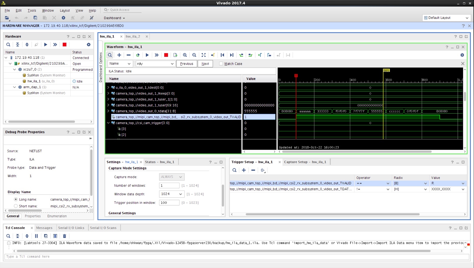

  • Hi, Jonny
    Thanks for your reply.
    1) Pattern Generation now works.
    I do receive below pattern. I guess this is expected pattern.
    Still more questions on pattern generation.
    1-a) I play with CSI_PLL_CTL and for both 1.6G and 800Mbps settings, I get same pattern from FPGA side. Does it make sense to you ?
    1-b) FPGA side is configured as YUV 422. Does it have any meaning ? I guess test pattern just generate fixed pattern and FPGA receive it ? Then even for real case, for data receiving, FPGA color setting has no meaning ?
    2) For back channel I2C access, it still doesn't work. (Eventually I want to make sure camera gets triggered but for now, I am focusing on back channel I2C work to make sure, the communication between 913 and 954 are good.) Below is register dump. Could you check it and let me know what is not right ? I did set the registered you mentioned.
    Register 0x04 value 0xdf below means 913 and 954 are connected ?
