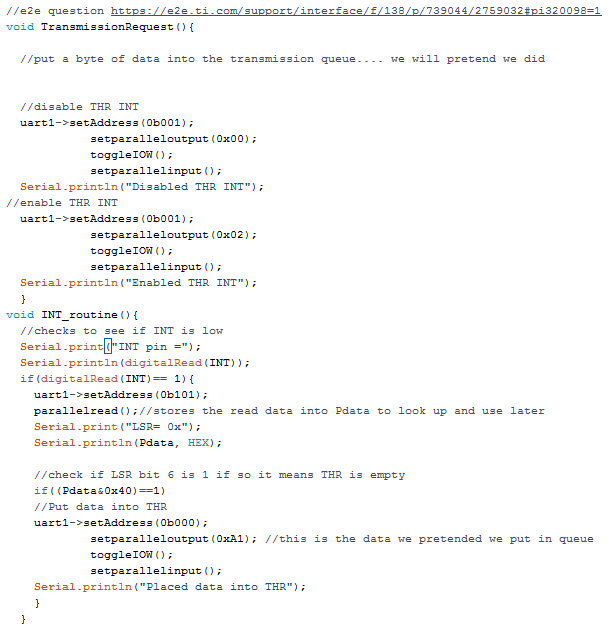

  • Hello Bobby,
    Thanks for always helping me out.
    I am not familiar with programming.
    Can you tell me the points to be corrected in the transmission routine below?
    An example sentence is OK.
    Transmission request reception routine
    1) Add the transmission data string to the internal transmission queue.
    2) Disable THRE at IER.
    3) Allow THRE at IER.
    (THRE interrupt is generated if this is EMPTY)
    Interrupt routine
    case THRE interrupt:
    1) Extract one character of transmission data from the internal transmission queue.
    2) Write transmit data to THR.
    (The next transmission data is transmitted at the next THRE interrupt)

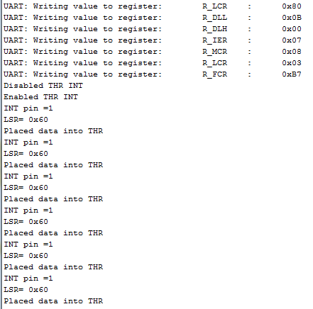

  • Hey ACGUY,
    I was able to finish my testing today.
    Here is the code I ran:
    Main code:
    Display after running code:
    As you can see, your interrupt servicing routine will always see LSR=0x60 and as a result the INT will always re trigger itself. It gets stuck in a constant loop of repeating the service routine. This is what I guessed would happen in my earlier post.
    To fix this I had to add an extra set of code, I ended up disabling the THR int inside of IER after sending the byte of data into THR inside of the service routine.
    When I reran the same main code, I was able to send data only once and the INT stopped triggering:
    -Bobby
