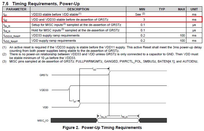

Part Number: TUSB8041
Hi Team,
The following Timing Requirement shows a minimum reset duration of 3 ms is required.
Is it applicable if my customer wants to reset the device dynamically after power-on?
Yaita
