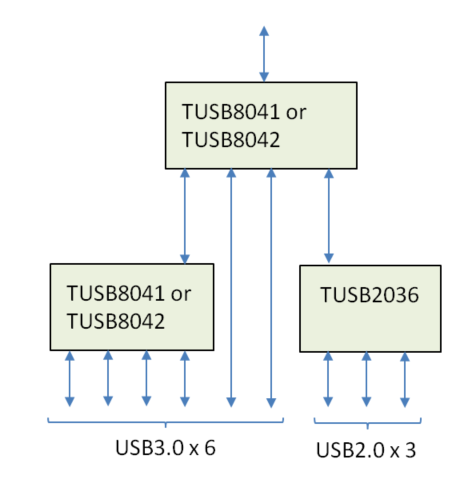

I would like to realize USB3.0 1:9 hub (USB3.0 x 6 + USB2.0 x 3).
They I want to confirm whether the below configuration work well.
Is this configuration no problem?
Oba
  • Hi Oba,
    Yes, this is possible but please note that TUSB2036 is a USB full speed hub not a USB high speed hub.
    Ports that are permanently connected to a hub should be marked as non-removable in EEPROM or using SMBUS for USB spec compliance.
