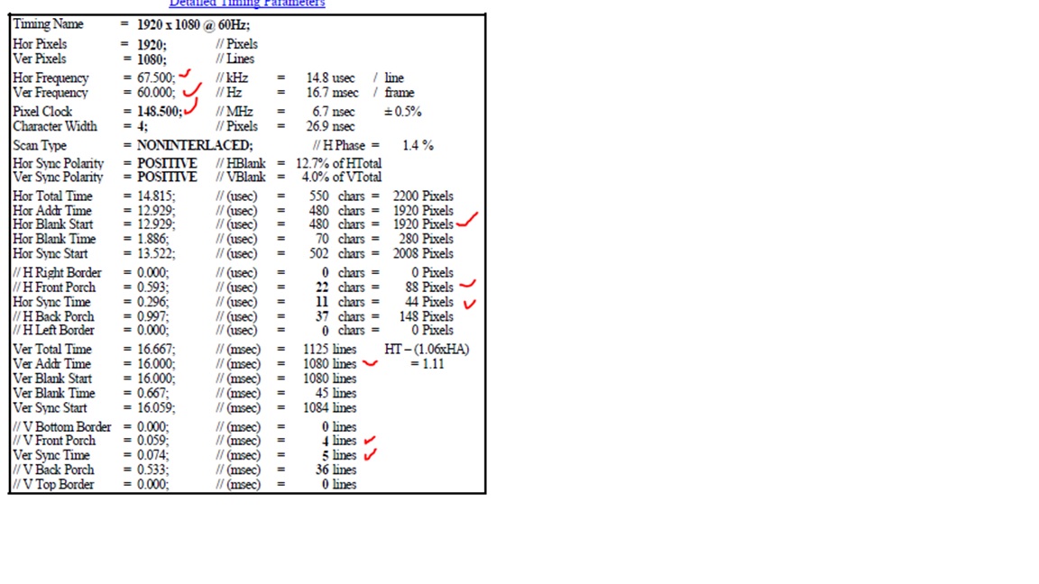

Hello Guys,
I am planning to make LVDS to HDMI converter with DS90UH948-Q1 and a openLDI to HDMI Adapter.The chip manufacturer of HDMI Adapter is asking for the following data.
I searched in the DS90UH948 datasheet but not able to find it.Please do the needful.
