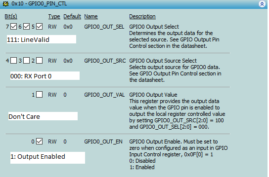

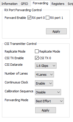

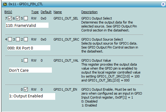

I have connected the GPIO  0 - 6 to my oscilloscope.
I want to  see the signals on the scope I am using the Analog Launchpad.
I want to know how i can i get the line valid and frame valid signals or else pulse on GPIO how to set the register 's and get   values on logic analyzer
What Register setting in need to change in the Analog launch pad. I am currently at the
Value =7F for GPIO_Input_CTL
Value=00 for  0x10_GPIO_PIN_CTL
Value = 00 for OX11_GP01_PIN_CTL
