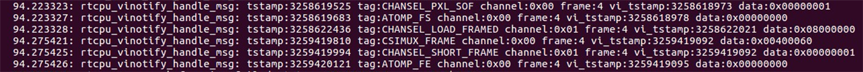

From querying the LINE_LENGTH and LINE_COUNT registers, it looks like the MIPI packet consists of
LINE_LENGTH: 2016
LINE_COUNT: 968
I have configured the TX2's CSI receiver to accept these as the input, however I am met with a frame length error.
I am NOT forwarding the truncated 1st line of the frame, however if I DO forward it, the error changes to a "Start of Frame" error
Admittedly I have only written V4L2 drivers for Sensor-only modules, and the LINE_LENGTH is just the # of PIX_CLK periods per line - roughly close to the horizontal resolution of the sensor.
Where does this LINE_LENGTH come from? I.E how is RAW12 1344x968 image generating a line length of 2016?
Is this denoting the number of bytes per line? (1344 x 12/8 = 2016)
Also, would it be worth investigating the FV_MIN_TIME- I currently have it set to 0x04 as I was experiencing issues with this on another system.

  • Hi Ryan,
    Yes. Line length is the number of bytes per line: 1344 x 12/8 = 2016.
    It is worth investigating into FV_MIN_TIME. You should check the spec for the imager to make sure your FV_MIN_TIME is set correctly to match the FV and LV rising edge time specification. You can refer to Table 10 in the DS90UB954-Q1 datasheet for how to set your FV_MIN_TIME.

  • Thanks for the Reply Jiashow!
    I believe the FV_MIN_TIME is set correctly, as I have the system working with ON Semiconductors' API and hardware.
    I did find that the default value was too long for the sensor's FV/LV timing, and it resulted in a distorted image (first portion of the frame was cut off- as expected).
    The value of 0x04 (*PIXCLK) is working for that system.
    Ultimately, I am starting to think the issue lies with how we have configured the CSI RX ports within Nvidia's TX2 Module.
